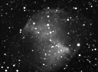

Variable star in M-27
Images are taken with the same instrument - 8" f/6 Newtonian through a 2x tele extender yielding a focal length of 240 cm. The Cookbook Camera worked at double sampling mode and 252 x 242 resolution.
Left
May 16 - 1999 - exposure time: 2 x 3 min. Estimated magnitude: 15.
Right
August 4 - 1999 - exposure time: 3 x 5 min. Estimated magnitude: 13.

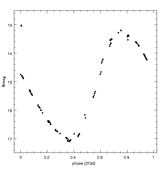

Light curve for Goldilocks
The light curve covers approximately 213 days - data by Arne A. Henden
The crudely folded light curve for this Mira based on 3 years of R-band photometry with our 1.55-m telescope. The period is around 213 days; I haven't worked at improving the period since there are still some minor tweaks to perform to the photometry. The main things to note are that the variable has a nice, clean, repeatable light curve, and that the range of variation at R (roughly equivalent to unfiltered CCD observations) is about 4 magnitudes.
